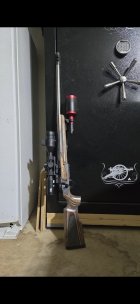

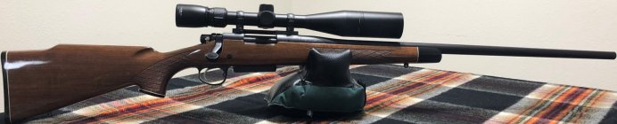

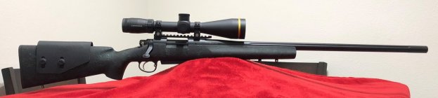

Both of mine are barely even wildcats just straight neck downs from their parent case and both are Rem700 based builds wearing Hart barrels. First pic is 20-222 shooting 40gr Berger w/H322 and lower pic is 20-250 shooting Berger 55's w/RL16 Nothing particularly exotic or exciting about either build but generally when you use all good parts/pieces and a good gunsmith you end up with good results.

Beautiful and classic looking wood stocked 700 there! What bullet weights are you shooting out of your 20-250? Powders and velocities?

I don't plan to do the .100 Shorty.... it was just an intermediate step to the .150 Shorty to test powder capacity. I should have .150 Shorty up and running before PD season.
It's way too cold to do any serious load work on the North shore.
I built it with the sole purpose to shoot the Berger 55gr bullets. I'm using w/RL16 getting 3750 from a 26in Krieger 8tw barrel. I've always wanted to work up a load using RL26 because I think there's probably another 100-100+ fps I could get out of it with 26 but it shoots so good with 16 it makes it hard to even want to try.
