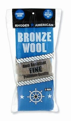

Recently, quite a few of us are wrapping Fine Grade of Bronze wool in a worn brush to remove hard carbon, and this has not shown any scratching in the leade angle nor rounding of the lands. Hard Carbon can be tough to get out. Free All actually is a very advanced penetrating oil that has a unique chemical in it that will attack carbon.
After normal cleaning with bronze bristle brushes, and you still find hard carbon, 4 loose patches with Free All, then scrub with a worn brush that has Fine Grade of Bronze Wool wound in the bristles, soaked with Free All will get a LOT of hard carbon out of the barrel. I have found that 40 strokes on a worn brush wound with Fine Bronze Wool, dry patch out, then check the carbon level, then repeat and you may have to wind more Bronze wool in the brush as it compacts.
I have most of the abrasives on the market today and also make my own out of various grades of Al Oxide and honing oil. I found that the use of any abrasive is a last resort kind of issue, but the Fine bronze wool wound in a worn bronze bristle brush is a real game changer. I use nothing but the finest barrels on the market, and my Hawkeye bore scope works pretty darn good in seeing bore surface finish, rounded lands, pits, and cracks.
Fine Bronze wool:
