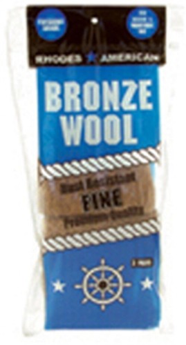

After Urbanrifleman introduced me to the Flitz Bore cleaner, I buy it 6 bottles at a time. I use the Montana Extreme Copper Cream first, then go to the Flitz bore cleaner for tougher applications. 308's with Varget, R#15, 8208, H4895, 7 Mags, can be a challenge. My brothers, friends in the deer club, all got Teslongs this year, and they are all using the Montana extreme Copper Cream, Flitz Bore cleaner with the Fine Bronze wool on their rough factory barrels.
We are all learning the economy of keeping the brushes, "FRESH". We will use a brush 50 strokes, then put it in a plastic box with dividers per caliber. We wind FINE BRONZE wool in the bristles that have 50 strokes on them, and use either Bore cleaner on the Wool or FREE ALL penetrating oil that has an ingredient that Attacks the carbon. Guys with factory hunting rifles are using the Copper cream of the Flitz bore cleaner on the Fine Bronze wool.
I shoot Krieger, Brux, Lilja, Bartline, Hart, Shilen, Wilson, and X Caliber barrels.
No way does a Hawkeye or Teslong bore scope show scratches in these fine barrels From the FINE Grade Bronze wool, and brother does this stuff take the carbon out!

Great info. I just ordered some fine bronze wool. thanks.
