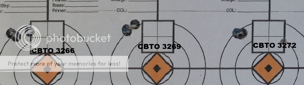

Sold on the value of .003", even more so in the 200 hybrid than the 185 Juggs. Willing to spend the money on the right tools like all those on this thread.

I've owned and used Bob's tool (BGC) many years now. The BGC will allow you to sort bullets so they give the best chance of setting the seating lenght the same on all the sorted bullets. I find your seating dimension will be within .001" on the sorted bullets.( Depends how close you sort the bullets) If you do not sort with his tool and seat bullets you will have a few out of spec, some loads will be .002-003" out of spec. So you could load 60 loads and find 50 that are within spec. I do not Use the BGC for every match because I think the Berger Bullets I use are very good . I do not know how consistent the dimensions are on other bullet makers though. So you can sort them before you load or sort after and use the out of spec for foulers.
CBTO 3272
Yes .003" makes a difference, even more so with hybrid. The picture shows the groupings each one increasing .003"
Berger 200gr Hybrid
jump
CBTO 3.266"
CBTO 3.269"
CBTO 3.272"
Thank you for the test. Far more valuable than theoretical discussion.
I had just loaded up a similar seating test this evening, but you beat me to it! Hopefully my results mirror yours.
