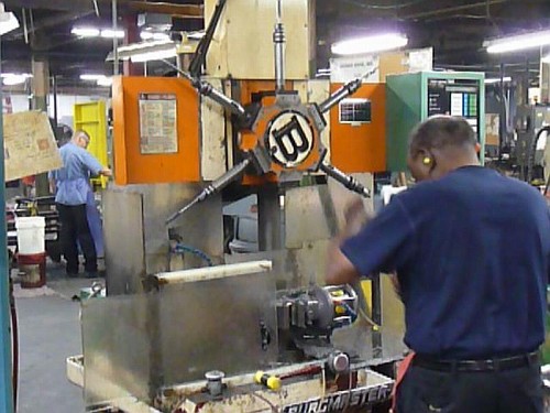

One of the things that was interesting on the Savage tour was the chambering. Barrel is set up in a milling machine type device with a tool head with four stations. First a piloted drill removed much of the chamber material, then a roughing reamers was employeed followed by the finish reamer and then a brass brush to clean it out. All with high pressure cutting oil from the muzzle.
The actual barrel to receiver was performed at a bench with the barrel in a barrel vise. Barrel nut, recoil lug and action were threaded on. Bolt was installed in the action and a Go gauge inserted. A pneumatic drill with a preset torque adapter was used to thread the receiver with the go gauge to the barrel. Then a calibrated torque wrench device set the barrel nut at 70 ft pounds. Finally a no-Go gauge was inserted to test for headspace and off the barreled action went.
