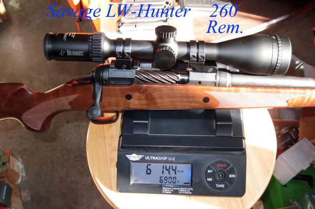

MyWeigh UltraShip 35 @ OldWillKnottsScales.com
They used to use one like this for FCNC in years past. Not sure what they are using now. Mine works pretty well ;)
I also purchased a similar scale for weighing my rifles. Of course it can also be used to weigh other things such as shipping packages on occasion, but they are of far less importance IMO ;). Even though I generally use this scale infrequently, I am very happy that I decided to purchase it, no regrets at all. When I show up at a match where my rifle will be weighed, I know without any doubt that it is under the limit. For me, peace of mind carries a pretty fair dollar value.

When I first got the "Ultraship" scale that's in the photo I posted earlier, the scale's accuracy needed to be tested.
Competing at Pella, Iowa in 1000 yd. Benchrest (2008), we had to weigh our Light guns (max. 17 lb.) and we also had to
weigh our Factory Class rifles (max. 15 lb.). So it was my intention to test the scale in that weight range. 15# to 17#
Taking one of my rifles into our local Post Office was out of the question. I had an empty cardboard box that I began
filling with boxes of bullets. This wasn't ammunition, but boxes of bullets. It didn't take many boxes of bullets to get
the total weight of the box of bullets to be between those two weights. The recorded weight of the box of bullets was then
checked at the local Post Office. They were close enough to give me confidence in the "Ultraship's" accuracy.
In all the years since then (2008) the scale still gives similar readings to what the match scales have reported for my rifles.
That would include shooting at BRRC of St. Louis, Vapor Trail Valley, Yukon, Pella and Big Piney.
Joe
