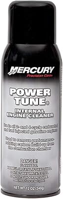

Baked hard carbon can easily be softened with "Piston Kleen"
then cleaned the normal way. I slop it in there with a bore mop
and let it sit a few hours. You'll push out black sludge.
What's your bore look like after that? Any etching?
Thorough Clean and this....
Mercury/Quicksilver Parts 858080K01 POWER TUNE @1 POWER TUNE ENGINE CLEANER
......The Hawkeye says Good Job........Use a brush.
