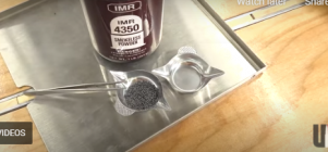

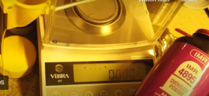

I'm lost.
In your video (at 6:20) you are measuring IMR 4895 and it shows it weighs about .02 grains each:
In the Ultimate Reloader video (at 6:20) he's measuring IMR 4530 and it shows it weighs about .04 grains each:
Friend just weighed one kernel of IMR 4350 and it weighs about .04:
not sure why you are saying UltimateReloder video is in error showing IMR 4350 weighing .04....
I'm lost.
Good catch newbie... I thought he was using the same powder, but as memory serves 4350 is not that heavy and I will look into it. I just don't happen to have any here at the moment, but I'll get some and confirm.

Hi ,I have a A&D 100HR A analytical balance that is accurate to .002 grains and indeed a kernel of imr 4350 weighed between. 038 and .042 grains I weighed several kernels

Hi ,I have a A&D 100HR A and is accurate to. 002 grains and I weighed several kernels of imr 4350 and indeed they weighed between. 038 gr and .042 gr so the FX 120i is correct
Checked some IMR 4350.
100 kernels of IMR 4350 = 4.1867 grains, average of .04187 grains/kernel (No half kernels)
1 kernel of VARGET = 0.0215 GRAINS
Resolution = 0.000154 grains
That’s more consistent than most powders. I’ve found a single kernel can weight less than half as much as a large kernel of the same stick powder. (Scale is an Entris 64)
