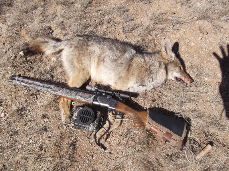

Not an encore shooter but have shot and hunted with a number of break action rifles over the years, mostly Euro drillings and combo gun and find that shooting a rimmed cartridge is much easier to work with. Cartridges like the JDJ line, Euro cartridges like the 5.6x50R, 5.6x52R(22 Sav. Highpower), 6.5x57R, 7x57R or even the venerable old 25-35 Win and 30-30 work well in a break action firearm.
Combo 12ga/5.6x50R Mag
Combo 12ga/5.6x52R
Drilling 16ga/16ga/6.5x58R(very obsolete but still effective)
There is a reason that almost all sxs stopping rifles and Euro break action rifles are chambered in rimmed cartridges. I makes them more reliable to load and extract.
I've tried a couple of combo guns with rimless cartridges, a 222 Remington and 223 and found they were just a pain with the cartridges slipping past the ejector while loading and slipping past the ejector while extracting.
