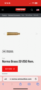

Best 22-250 brass? Norma??
OK, I proposed this question before on here, and I didn't word it correctly to get the answers I was hoping for. So here it is again.
I want to give my new cases the full prep,. So in what order would you arrange the steps.
Flash hole drilling, cases length trim, deburring, fire forming, weight sorting, capacity sorting, light cleanup neck turning, more?
Flash hole drilling on Lapua brass?… no
Light cleanup on necks?.. I wouldn’t on a factory chamber, I have seen it hurt accuracy but if you need to I would go over about 80%
If it were my I would weight sort it if I was competing with it, size it, chanfer the necks, load it and shoot it. Then maybe I would trim it before second loading

Back in the day, I could have answered this myself, but it isn't back in the day any more. Looks like I have aseveral choices now on new unfired brass.......NORMA? Hornady, Nosler, Lapua or Winchester. There is also Remington, but I know better than that. There's quite a
I've been kicking the idea of fast twist 22-250ai. But that will probably happen after I wear our one on my factory remingtons. I really do love how my factory guns shoot.
What the twist? 1-14?
few considerations, but here's not a better place in the world to ask than right here
