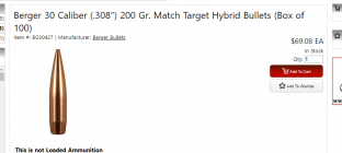

200 hybrids 500-count boxes:
bulletcentral:
precision reloading:
200.20x:
MileHigh:
