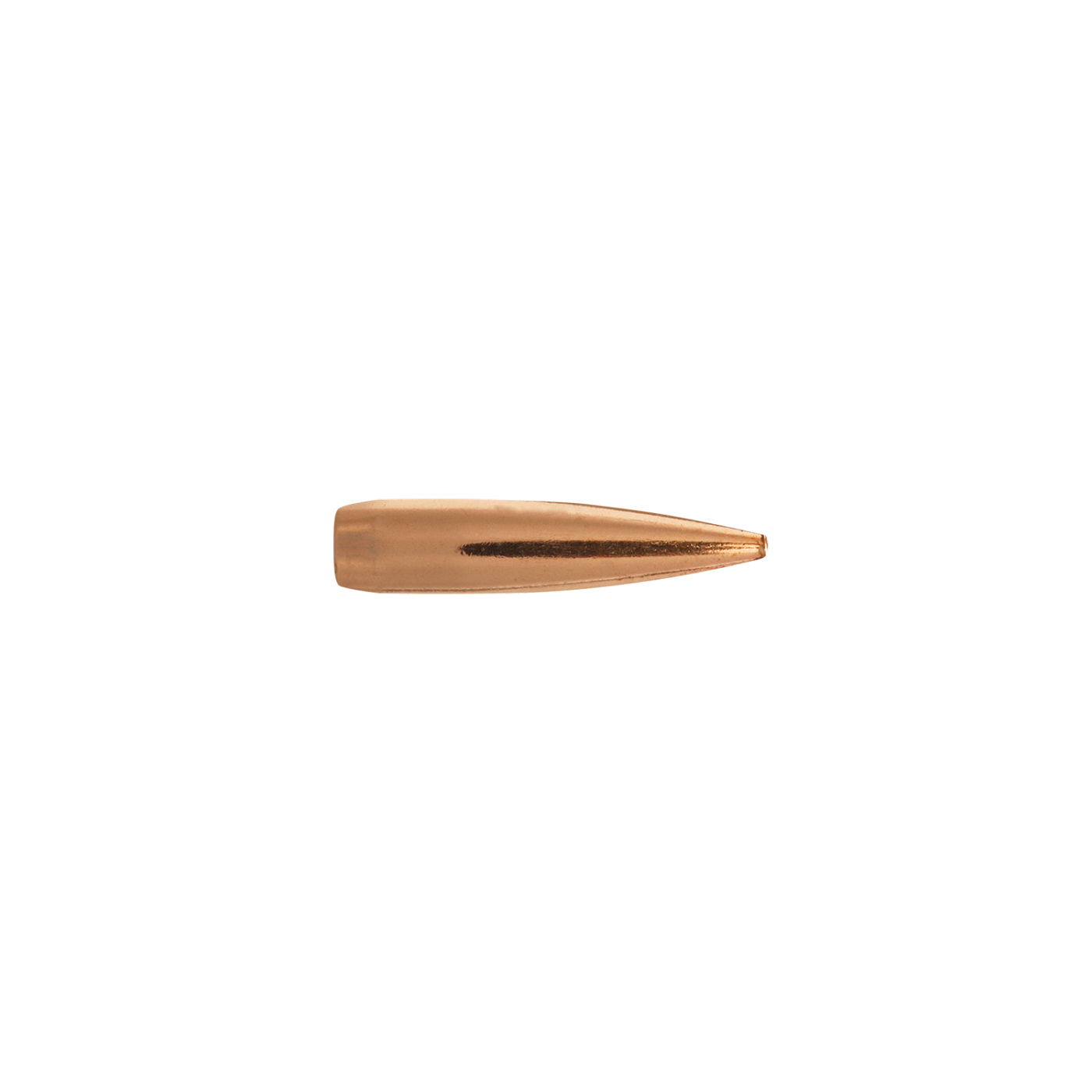

I will be posting for sale 1000 Berger 55gr 20 cal next week when I get home from vacation. I’m just checking to see if there is still any interest in these bullets.
