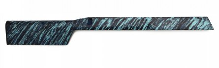

FWIW the barrel channel of my Revolution was exactly 1.2” and I used a barrel contour that started at 1.2 and necked down quickly to .900 for the rest of the length. The 1.2” section contacted the stock wood and I needed to file a tiny bit of relief when I fitted the gun because I didn’t want any contact there. (Would it have mattered considering it’s the 1.2” stub and the rest of the barrel is .900, I have no idea, but that was the choice I made).
I am puzzled by your comment that you bought a Revolution stick but didn’t want a “true” Benchrest stock. What is the difference?
1.2” diameter barrel at 25” length. RBLP Vudoo action. What I meant as a BR stock was something like this…. The revolution stock looks a little more traditional yet still has the 3 inch wide forend and flat bottom. It looks a lot better than the one picture below to me.
