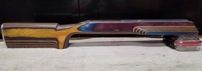

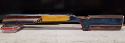

Trying to come with a 22lr build for non sanctioned local matches. Would prefer a single shot action and a 24-26” heavy barrel 1.2 or 1.1”. Shooting at 50 & 100 yards. So far I have come up with 2 options. Order a vudoo barreled action with Bartlein BR contour (might be smaller diameter) and get a revolution 3” benchrest stock from Urban Rifleman or get a 2500x action and send it to a local smith to have a barrel put on and try to find a stock for it ( not really wanting a true BR stock). Thought, suggestions or did I miss another option.
Thanks for starting the thread. I’m especially interested in what you are learning about the stocks. I have several of those 3” stocks from Urban Rifleman and a few McMillan stocks that I use for registered centerfire BR matches. I’m curious about your statement that you are not really wanting a true BR stock. Is it because there are no registered rimfire matches in your area, or some other reason.
From what I have learned, most have to be in inlet and the gunsmith in my area only does barrel and action work. I have no one to fit such a stock. I have also looked H&S precision and their PSC competition models.
Yes it’s easier to find a gunsmith than a gunsmith that also does stock work. The reason I asked is because I noticed that Voodoo sells complete rifles and some of the options include BR stocks, so Voodoo would do that part for you. I’m guessing that would include a long wait time but sometimes you get lucky.
@22vartarg
Randy Owens made a very fine benchrest stock for my Vudoo barreled action.
Randy Owens-Rotex!
