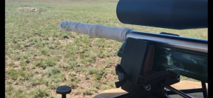

Yeah. So far I've simply been wrapping with paper towels soaked in cooler ice water.Screenshot_20230701_085353_Gallery.jpg But I'm thinking about something cleaner, and more fixed/permanent. I'll possibly open my barrel channel a little more too and wrap the barrel all the back to the action. In this case, I'd not only use in the field, but utilize for targets/load development too.

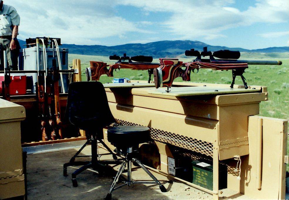

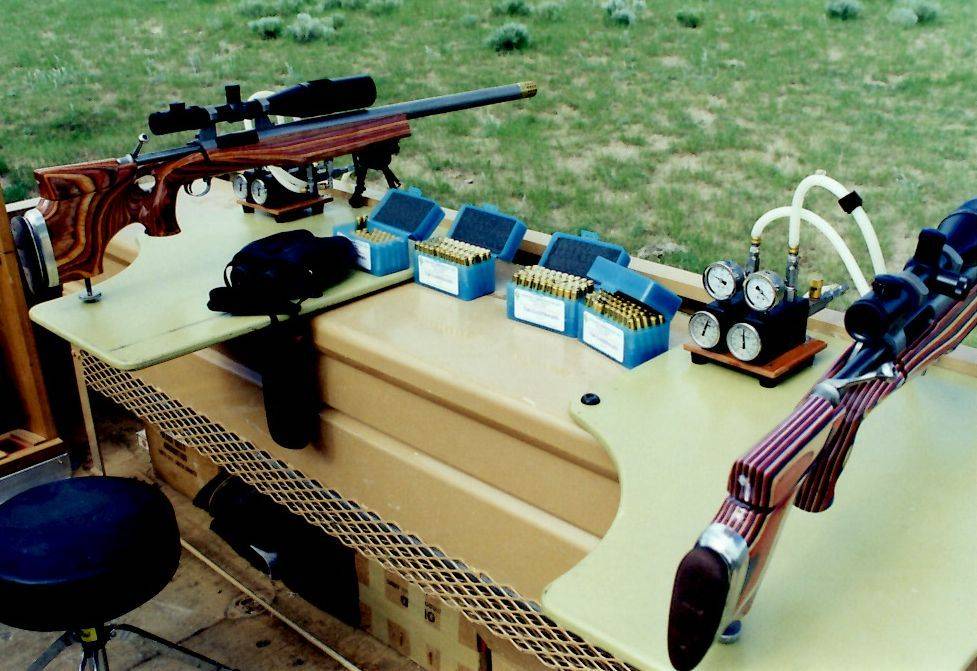

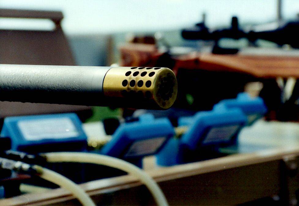

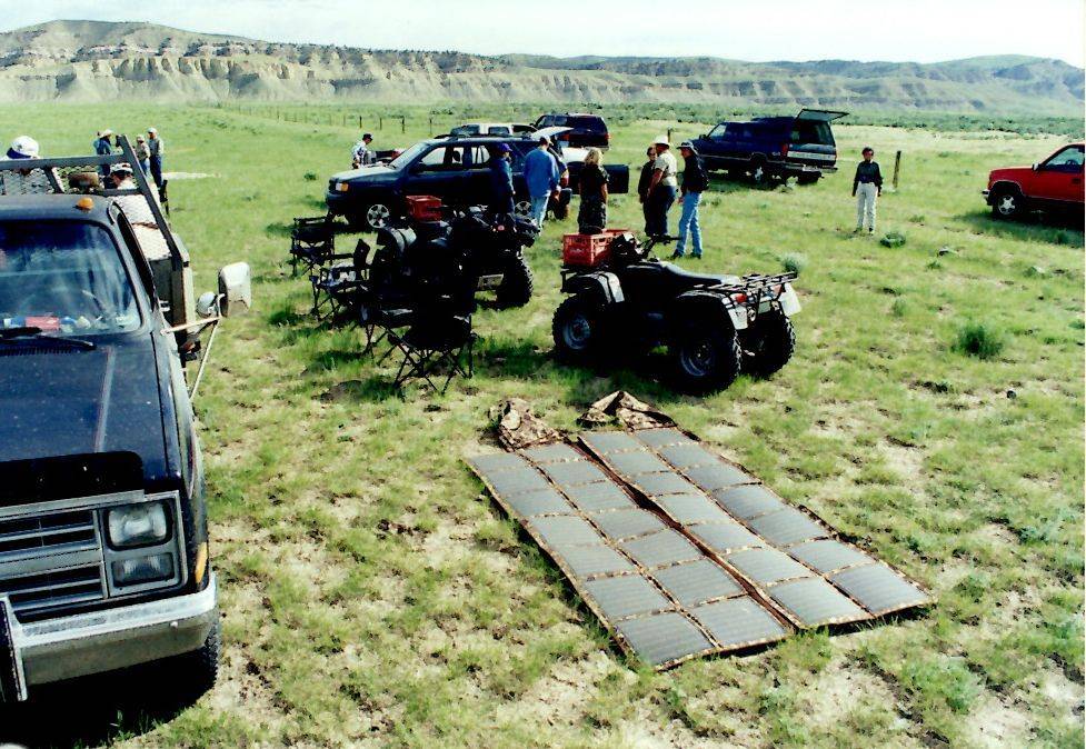

But the coolest (pun intended) setup I've ever seen was during a PD shoot in WY around 2001 that featured a "war wagon" equipped with water-cooled custom rifles (Hall actions, P/N SS barrels with water jackets and brakes). We could shoot as often as we wanted with the 6-284's and 223's without fear of any overheating. A 200 gallon water tank at the trailer tongue, water pump, pressure and temp regulators, all done via a large solar panel for power.....a very well thought out setup if I've ever seen one.
Poor image quality, I know, sorry. Scanned from an old print, but notice the condensation on the barrel. They stayed at a regulated 46*F the entire time.
The solar panel for power...worked as advertised.
