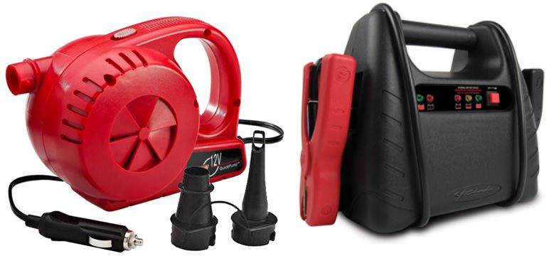

I use a Coleman Quickpump 12v ($20-$25), high volume, low pressure. It plugs directly into a Schumacher 500 amp jumper box ($45-$50). The box charges with just an electric cord and has a power outlet just like a car. You could just power it from your vehicle if you have it near by. I adapted a heavy clear hose that is just small enough to fit into the chamber just like Twoboxer's picture in this post. The air blows out the muzzle. Normally I can cool down enough in about 60 seconds between shots in 85-90 degree heat outside. Otherwise, 4-5 minutes with the rifle sitting on the stock letting convection cool it. There is no thermal shock to the metal. I would never consider water or anything else in a hot chamber.
