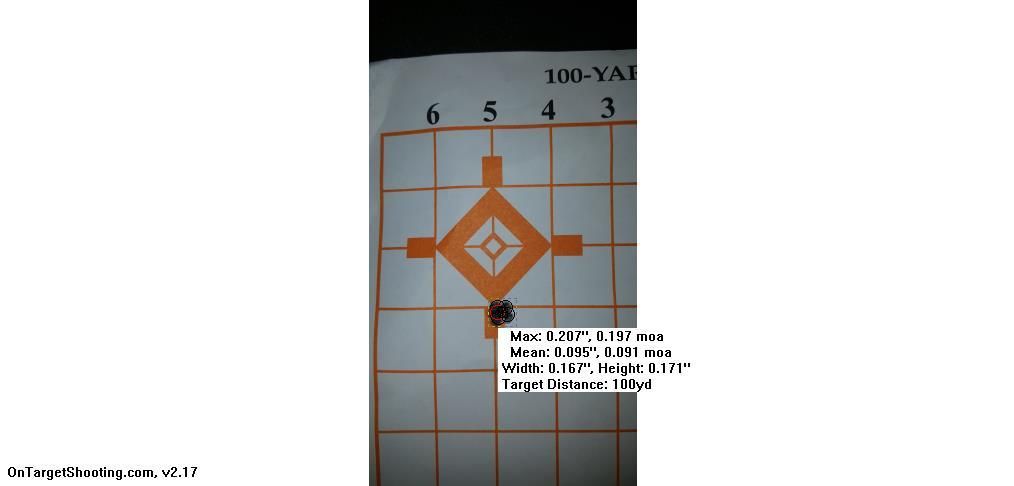

Now for a fun gun I am all about the barrel nut. Actually the barrel nut forms the shoulder. Only thing different is it is adjustable. For quick barrel changes without having to worry about headspace I glue the nut on with locktite. You can order another barrel even in a new cartridge and have it in a week. Or in normal times you can.
And a well built savage with a premium barrel and nut will shoot. Problem with them for bench rest is the trigger and cycling the action.
Original load development

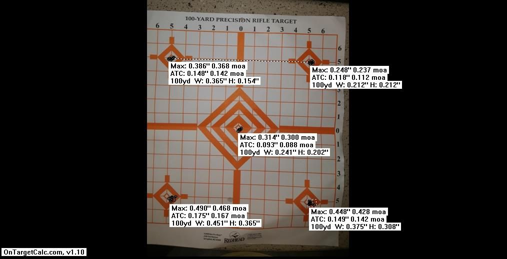

It is very simple, if you never intend on removing the barrel until it is shot out go the shoulder route.
If you intend on removing it to swap barrels or for whatever reason, then you should go the barrel nut.
Me I like my Barrel Nuts.
Exhibit A
Dean View attachment 1227497
