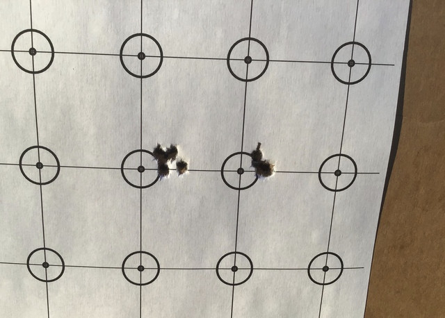

Here’s a group I shot at 100 yards with my Dakota in .204 Ruger. It’s a 40 grain Berger using 8208. These .20 calibers are something else.

Nice group! What was the load and velocity? The charge is 26 grains of 8208XBR I presume.

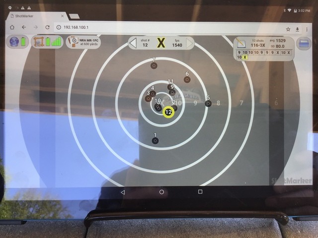

20 PPC here and not much experience yet but I can tell you I see why people love these 20's. Have 1500 39gr SBKs coming and a second barrel chambered and ready when the first one dies.
No recoil, flat as flat can be trajectory and I have rang steel to 600 without issue. Predators beware!
