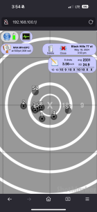

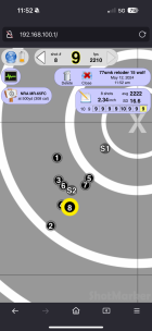

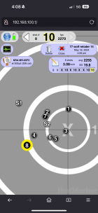

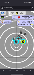

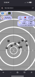

Before on left, after on right.
Wind was a lot more tricky today than for the original shots. For this rifle, I'll admit no improvement. Worth noting that the barrel/upper were a good/snug fit to begin with. The rifles I've seen success with before were like a hotdog down a hallway.

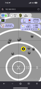

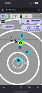

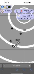

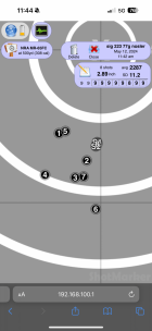

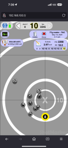

I take it that you felt comfortable that the wind did not significantly impact the 'after' groups?
I'd say net-net it's the same. The wind was all over the place today.. first test was pretty smooth from one direction. This range kills me at 200. If I went out to 500, put up flags, and took my time, I'd have the same size groups. We don't call it our toilet bowl for no reason :)
