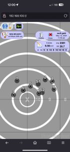

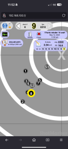

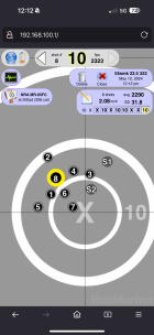

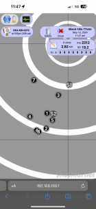

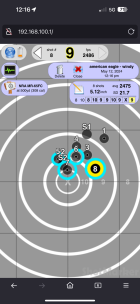

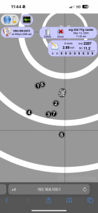

Man, the "Crap I don't need" projects really got in the way of this one. So I packed up for the first half of the test!
All fired @ 200, in the blazing sun, in black shirt black pants. Light wind. Semi-rapid type fire. No flags, just the hair on my ass.
