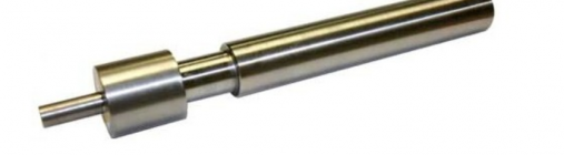

Is that all you're going to lap the face? I've been thinking [and doing] that ~ 80+ % of the face should have the anodizing at least being to show wear.
My hands were dirty so I didn't want to get my phone out for pictures... but I use a tool like below with some compound on it. I've cleaned up the lapping face on the lathe a couple times, because it wears.
The bedding part = coat the tenon in loctite or JB and jam it in and lock it down. :)
Why not just face the upper in the lathe? I have the Midwest URR, I chuck it in the 4 jaw and dial it in. Then slide the upper on and go.

I already have the lapping tool and it works fine.
What secures the upper onto that URR mandrel?
Obviously, I can't guarantee for every upper, but mine slid on and the raised fin held it in place. Very light cuts, I didn't see any movement whatsoever and the receiver came out square. Checked with machinist square and surface plate afterwards, could no longer see any light.
