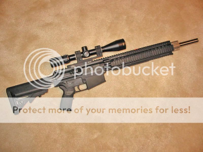

Here was my 308 AR when it had a heavier 18.5" Krieger stainless barrel and an Armalite gas block on it. It originally started life as a 24" DPMS Panther rifle 6 years ago. Now I have a lighter black Fulton 18.5" chrome lined barrel on it, and an A2 fixed front sight base. In my mind, the A2 FSB and collapsible stock is the way an AR should look. The accurate groups you see in the target were fired with the Fulton Barrel....NOT the Krieger. While the Krieger barrel shot tighter groups more commonly then does the chrome lined Fulton barrel, it was not frequent enough or much easier enough to do. So, I sold the Krieger barrel and gas block as I saw no need to have all the good money tied up just to make it a heavier rifle too. It is my personal opinion and taste that an AR rifle should be a handy combat rifle. This is why I will never again have a fixed stock on it, or a heavy 24" barrel (like the original 24" Panther as it started life) Again, that is just my personal taste. I enjoy trying for tight 5 shot groups from both my LMT collapsible stocked AR10 and AR15 rifles.
In the end, I have NATURALLY come to enjoy shooting the AR15 much more. It sounds to me like you are using reason and logic as to why you need a 308 or 260, and why you might enjoy it more then an Ar15. You haven't yet come to a natural like or dislike because you're still exploring. Logic and reasoning are precisely how I chose my AR's 9 years ago at the expiration of the AWBan. It wasn't until I've owned all 6 different sizes and variations of an AR10 and an AR15 that I came to definite likes and dislikes. So, it is my opinion that you may never know what you really like and enjoy more until you do it. If a 260 or a 308 is what your thinking of buying, I think you need to satisfy your itching desire and do it. Buy an AR15 of your choice too if need be! Keep them in nice condition, and you can always sell what you don't like later. My current 18" RRA carbine AR15 that I like so much now started out life as a 20" NM A4! It will often shoot 5/8" 5 shot groups with its LMT stock.
But to answer your original question again, all 3 cartridges (223, 308, or 260) are capable of the same good accuracy out of an AR.....depending on your barrel, stock, and your shooting skills.
EDIT; BTW....Of all the AR's that I have owned, my favorite is a 16" barreled Colt 6920. LOL It's got an Eotech & magnifier, BUIS, redi-mag, and LMT stock and it shoots 1". All that and it still weighs 2 1/2 lbs less then my light weight barreled 308! It's just fun to shoot.
My previous set-up; 308 DPMS with $525 worth of Krieger Obermeyer barrel and Armalite gas block.
Target groups fired with Chrome Lined DPMS 18.5" light weight barrel;
