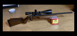

Well I bought another new to me gun. It’s another 64 action in a nice br stock, 21 inch barrel where my other is 25 . Yea I know it’s not custom or even 54 grade but I needed 2 similar guns to hand down since I have twin daughters. Took it to 100 yards yesterday evening with a few different brands and lots of ammo. It shoots right with my old 64 action gun I have. Both are fun and all I need (for now). Dunno how this stacks up but we will have a lotta fun shooting these. Thanks for all the replies guys.
