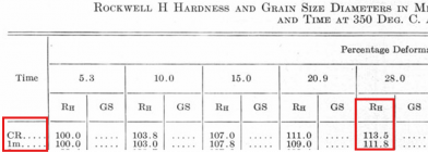

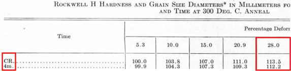

This chart explains all you need to know. Increasing cold work speeds up the annealing a little since it puts energy into the metal. If you assume a piece of brass has 21% deformation from sizing or cold rolling you can see what the hardness would be at a given temp for a given time. Looks like 300C (572F) at constant temp for about 10 minutes has no observable hardness charnge. It doesn't matter what the torch temp is it's the metal temp. The fact that the neck just turns red indicates that the brass just reached about 1050-1100F. The case body about a inch below the shoulder just reaches about 400F as proven by guys using 400F Templaq. The cooling rate is probably around 50F per second. I have done several 1000 cases with a torch, I can pick the case up after about 30 seconds. I guessed that the cold work was 21% to create an example. It may be a lot less.
The chart indicates that at 300C (572F) it takes about 12 minutes at constant temp before a noticable hardness drop starts.
To many people guessing at what's happening and thinking it's fact.
To sum everything up: The case body let alone the case head never reaches an annealing temperature and time.
A few posts up you're assuming 28% cold work. Now you're assuming to 21% cold work. I know where you're getting these charts from, how are you determining the amount of cold work we're dealing with? It can make a huge difference
Above you said it takes 2 hours at 300C for 28%CW to drop 1 hardness point. I guess 4 min is the same as 2 hours.
...and if you're off in your estimation by 50C it drops 2 points in under a minute
Under normal circumstances I don't think annealing the case head is a problem but for crying out loud, don't switch the assumptions around to fit your argument and at least report the data accurately.
I said I guessed at the % deformation since we don't know what it really is. Your example was 28% deformation mine was 21%. Both % may be way to high. It may be closer to 10%. In any case your example shows a drop of 1.7 hardness units at constant temp for 1 minute at 572F which is a meaning less hardness change. 300C is also way above the temp any case body or case head will ever see. The case body and head probably never gets above 300F. Your example was 1 minute. The cooling rate is very fast. If it's 400F by Tempilaq 1" below the shoulder it's below 400F for almost the rest of the case with rapid cooling. You can nit pick where you pick a point on the graph. A case will never see 1 minute at temp.
Sure, both your guesses may be high. But if you're just guessing then it's equally likely to be a lot higher :D
In post #25 you used 28%, then dropped it to 21% in post #34. Now it could be as low as 10%. That document lists values up to 70% cold work. Do the research to figure out what range you're in, then you can use the correct sets of data from that study.
