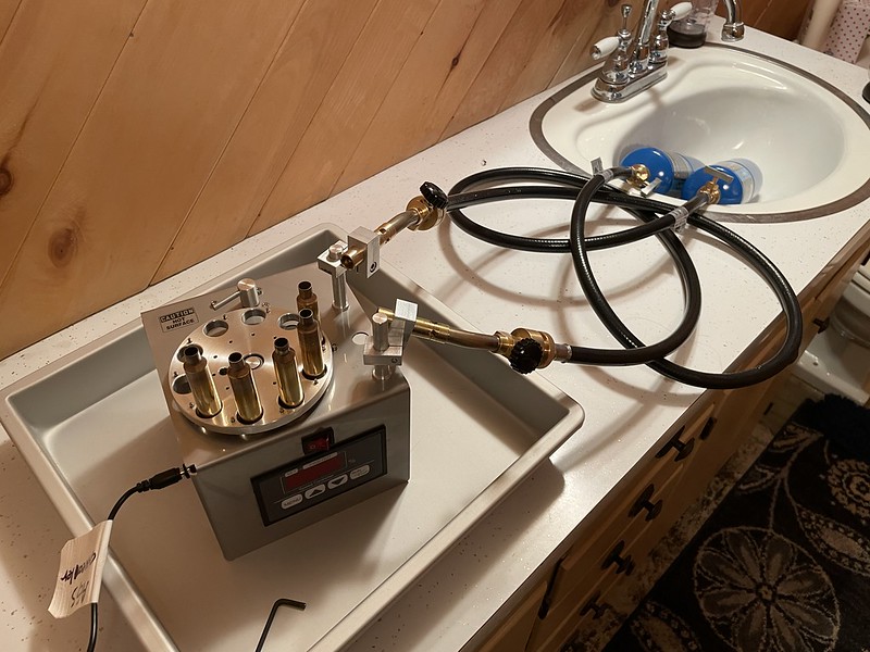

I'm an accuracy-minded hunter, and I use the AGS 3.0 annealer. I do small batch runs, and 50 cases at one time would be a lot of cases for me. The AGS works very well for this volume of annealing. They are currently selling for $280 with free shipping. It is a lot of bang-for-the-buck.
I particularly like the two-torch design of the AGS. It makes annealing the larger magnum cases go fast. My first annealer was a one-torch design, and the dwell time for big cases was a little too long for my comfort, although it worked pretty well for smaller cases. Also, with the AGS, I like that the flame is not directed close to any part of the annealing machine, itself, thereby preventing the possibility of heat damage to the machine.
