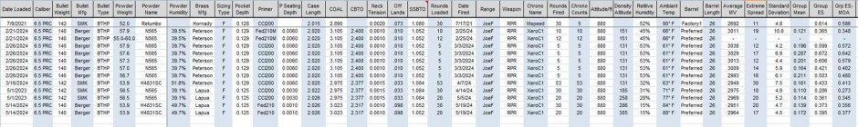

I record loading details and result details for all my outings:
This target should give you an idea of the kind of results I get with just a Ruger Precision Rifle 6.5 PRC with a 26" Preferred Barrel Blanks barrel that's got over 1,900 rounds on it now:
