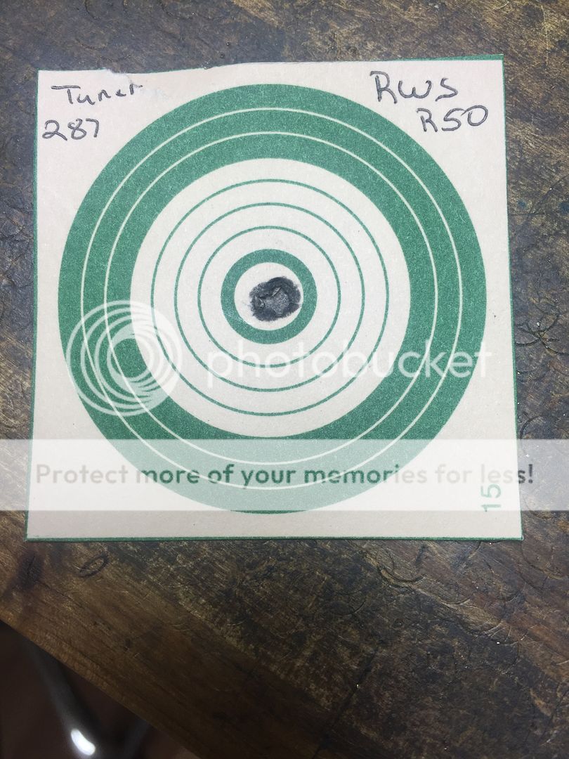

Late this evening I setup the Turbo rimfire with the added mid barrel tuner on it and began testing by torquing the Pappas mid barrel tuner and shooting two shots. If I had a good looking two shot group I'd keep going and usually by the 3rd or fourth shot I'd have a flyer. So I kept tightening the tuner and kept repeating the two shots and again repeat with more if I thought I had a promising group going. After going thru nearly two boxes of R50 ammo I decided to back off the screws on the tuner and after a few test groups the next twist of the wrench I yielded two shots in one hole, so from there I kept shooting until I had actually put 10 shots nearly into one hole. Here is the target shot.
Before the mid barrel tuner the rifle was yielding groups around .150-.160 for five shots on a real consistent basis testing a few days in a row.

Someone with more knowledge of how the mid barrel tuner works will have to chime in. I honestly have no clue. Another member here told me where to locate it on the barrel and how to tune it. So I did as he said and produced the group pictured.
As for aim point per the other poster asking. There is a little tiny dot in the center of the target. I aimed at that and fired away once it was gone I just centered the dot of my scope inside the ring and just kept shooting.

Very nice group! As far as mid barrels, I've had best luck getting all I can out of the muzzle tuner, then adding the barrel tuner. Looking at what you have, I don't think a mid barrel tuner will help if it constintaly shoots as pictured. My best rifle I couldn't make better with a mid barrel, only equil so why use it. Another rifle it helped a bunch. Again, nice group!.
This group posted was with using it. Before this the rifle was shooting in the mid .1's with same ammo and tuner settings.
