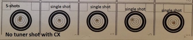

knowing how it can shoot without a tuner will provide a lot of information on what you are doing with a tuner is really helping or actually hindering on getting the rifle to shoot its best.
Here is an example a Suhl with a 22-3/4 .900 Shilen first shots out of a clean barrel no tuner that 5-shot group told me i didn't need a full 8+ oz of tuner

I should have also mentioned that without a tuner it will also show how good the ammo you are using to tune with. worst thing to do is use unproven ammo to tune with, you will never know was it the setting or the ammo. the lot of CX,1962 is a proven lot from the Mesa test center producing a 11mm group and this was off a rest not from the jig.
