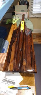

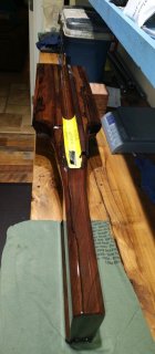

Do you have any more pictures of your rifle stock you would care to share?

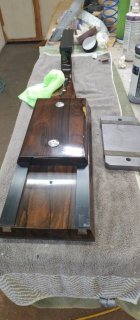

Hal, I have come full circle to throwing light and topping off manually. I weight on the sartorius 503, which I think is obsolete now. You can't get exactly perfect with 4350 anyway, although I try. I will dig around for more pictures, but our lighting is crap at deep creek and mostly it looks black in those. Here's one that shows the mount, and one of how it's life started!

That color of that wood is fantastic. That stock is flat BEAUTIFUL.

There's 2 layers of 3/8" lead inside of the belly. The wood is something like 50lbs a cubic foot, but lead is more. @Roy has a lot of lead involved throughout the stock.
