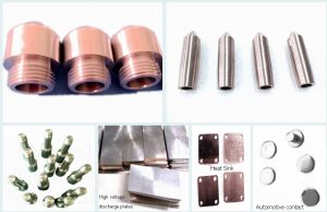

From what I've read, where ratio of copper to tungsten favors copper it is easier to machine, but generally it machines like gray cast iron.
70/30 machines very well with standard tooling. 80/20 isn’t horrible but I wouldn't go any less.
I’ve used 93/7 and it wears out a few bits before you’re done. I tried drilling and tapping a nice piece of pure tungsten I got once and gave up on that quickly! I ended up putting it in a copper tube and pouring lead in around it with a S/S plug for the screw. Worked great but more effort then is required.:rolleyes:
I agree with Al, 80/20 is a good compromise if you can find it.
The copper alloy helps a lot. I found and bought a piece of tungsten and used it ONCE. Not tungsten carbide, but tungsten rod. It was tough as hell but I did manage to get a hole in t and tapped. It cut in a bandsaw, actually pretty well but other machining ops were tough and yes, it was a lot like cast iron, as it appeared a sintered material, fwiw. But as Al said, the 70/30 machines pretty good and is actually easier to find anyway than that tungsten rod was. I prefer the 70/30 over the 80/20/ The 80/20 gets pretty hard to work with. I think technically, it's Tungsten copper, where the big number is the tungsten..fwiw. And even the alloy cuts a bit like a really tough brass, somewhat like cast too, just no nearly as difficult to work with, ime.
There may be some tricks to working with it that will help. My experience machining it is limited to these weight systems, so certainly not extensive at all.
Working in the Radiology field, I had access to used tungsten copper material that older XRay tubes used as anodes. As newer tubes were developed that used rotating tungsten copper discs as the anode, the older tubes were phased out and often either tossed out or sold for scrap. -Al

You only have to play with the 100% stuff once, and that's enough for most of us.
Yes it is a sintered material, I am not quite sure how they introduce the copper into the alloy.
