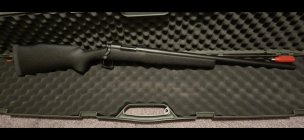

So I have yeah, two rifles built off of the bell and carlson m40 stock . One has a heavy palma barrel on it and the other is an m24 . They are a little a muzzle heavy. I was wondering what is the easiest way to add a little weight to the rear of the stock to help balance it.

Drill a hole or two in the butt
Add lead Shot
You can make a slurry of lead shot and epoxy if you wanna
Tungsten Fishing weights also work
One of my Mcmillans has a good few pounds of lead shot to balance the big heavy barrel out
Man does it balance and shoot nice, better than any gun I have

I'll have to pull the but pad ans see if there's a hole already
I used small block chevy piston wrist pins that were filled--put 2 of them in holes behind the butt pad--was easy to do--the added weight helped two nose heavy varmint rifles ride the bags perfectly! Even on a bipod like I usually shoot them the feel and performance was excellent--I cut vertical stringing completely --that is what got me looking at the problem --It made a huge diff in the way both rifles shoot--I had 28 inch / 1 in diameter and boy does that make the average rifle nose heavy
A Tip--Make the hole a snug slip fit -and Limit ANY travel for and aft or it will hammer in there
Best thing I have done for these rifles
