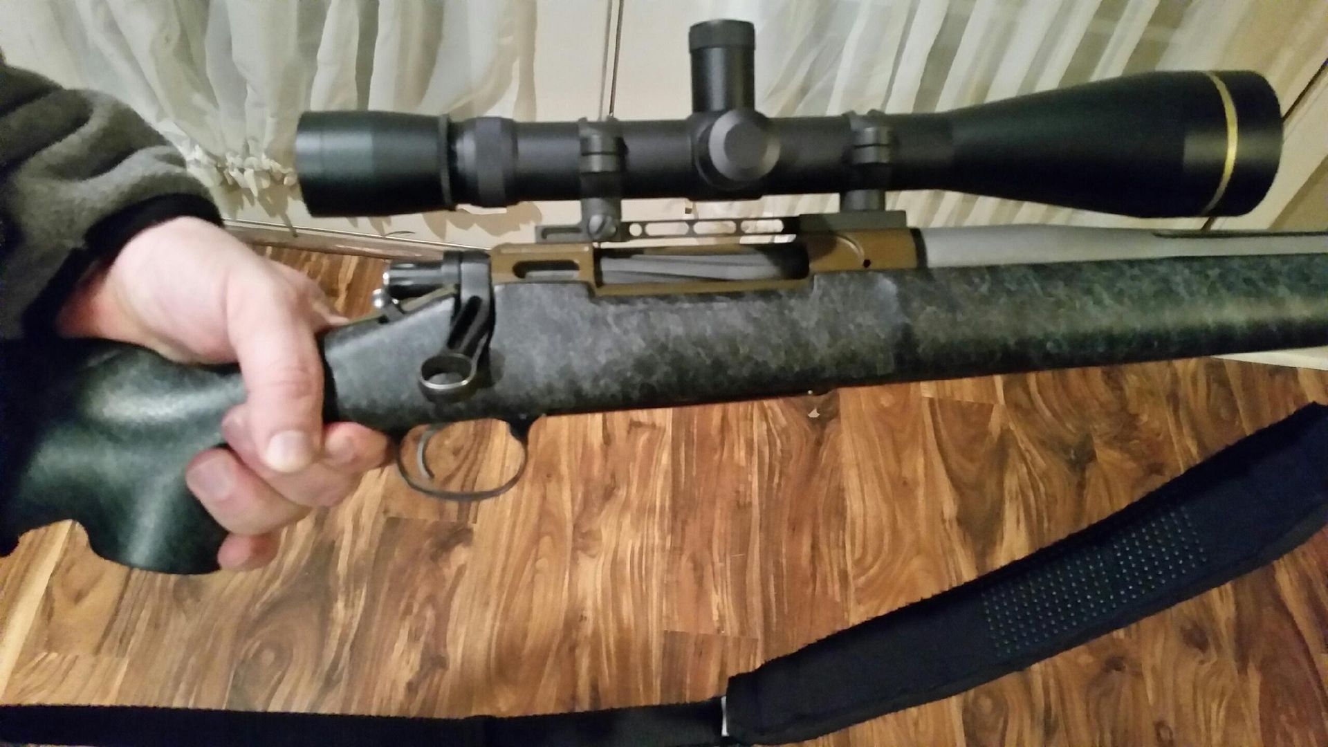

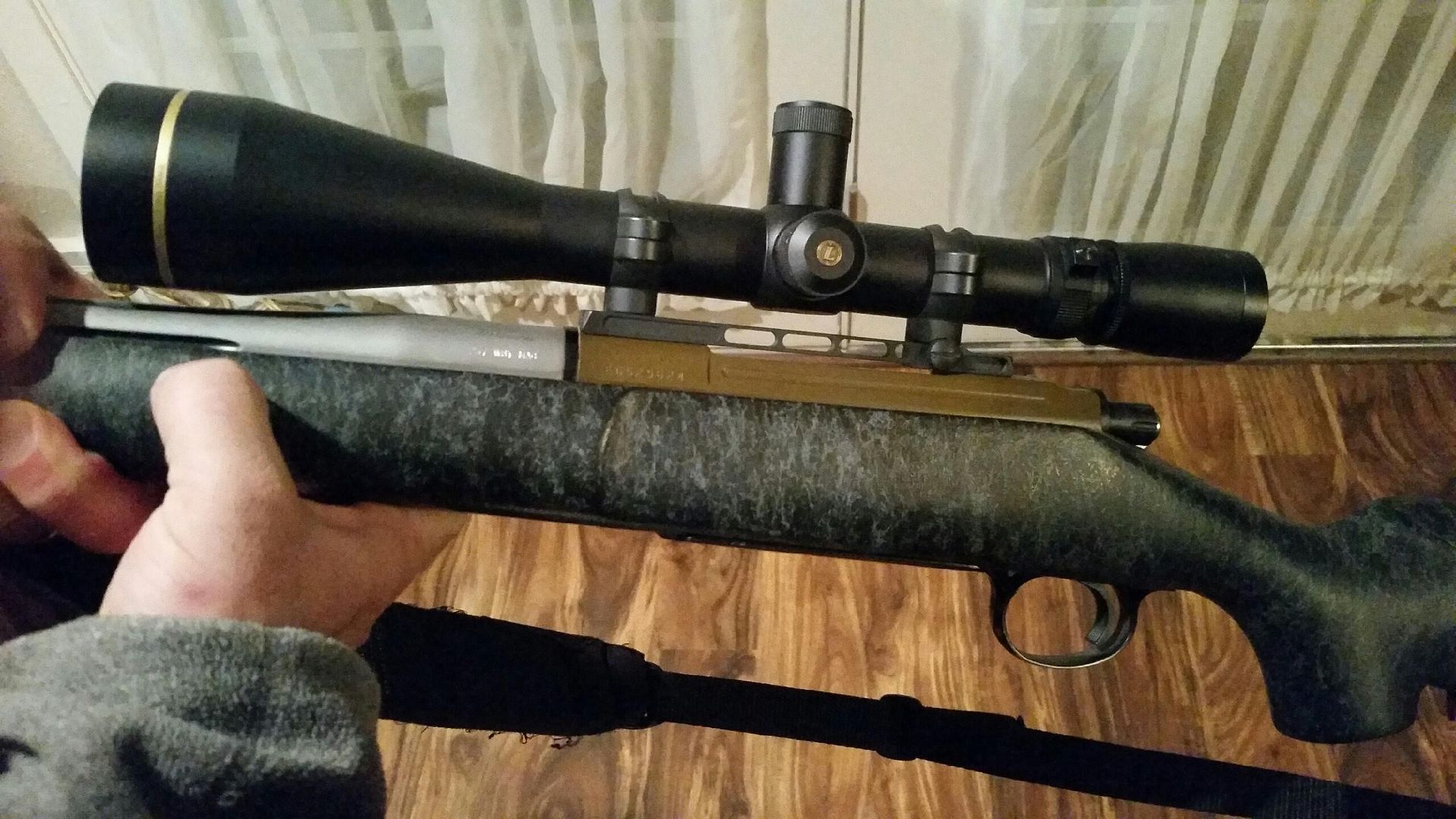

But everytime i need to build a lightweight and check on titanium i just skeletonize a remington
Are you talking just the bolt or the receiver as well?
Do you have a pic showing the skeletonization?

Heres one i did years ago. I even got the scope rings and bases aong with the bolt shroud and handle. I usually mill slots on the non port side like i did on the port side of this one. This was an early one so i was scared but this guy is the first to send me pics back

Remember the Savage bolt head is heavier, the Ti bolt is steel and heavily fluted. I don't think you can cut a CM receiver in half and get within 8 oz of the Ti receiver.
