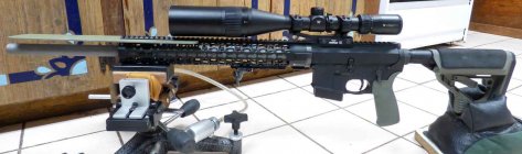

I know this about adding weight to an A2 but I added weight to a Ti-7 adjustable on a 24" bull barrel.
Now have a 28" bull barrel and a 3 pound bipod.
Cast a lead weight to fill the space behind the extension tube with the stock adjusted back to my pull length and filled two copper tubes with lead for the storage compartments.
For prone F-Class I added a 3 pound bag rider. Aluminum box filled with lead. Got me a little over 20 pounds.
A2 with the cast lead insert. Buy once, cry once.
