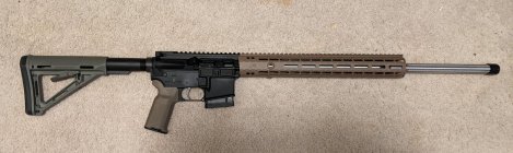

I recently built a 223 Whylde 24" 1/9 EBCO Bull Match barrel. I liked it so much I built a 2nd one with same Aero Enhanced Upper but added an adjustable gas block.
The recoil reduction is not really needed on a 223 its more to keep the varmint in the scope on higher powers. And was wondering what works best to get the least amount of scope movement.
I have a Odin Gas block on the second build and was wondering what buffer/spring works best for this?
Does a light buffer + light gas setting work better than heavier in terms of scope movement after each shot? My other one has a fixed gas block and seems a bit over gassed but other than that shoots and operates fine.
I figured maybe setting the gas using like the lightest bullets I will shoot. 40gr -69gr is the range it shoots well probably end up with 53gr for PD trip.
Buffer weight - ?
Stock A2 vs the one that is on it in photo. I've seen a few like this use A2 stocks not sure why, maybe weight distribution?
Any advise is appreciated.
Put a 7" or thereabouts suppressor on it. I can see impacts at 500yds (that's as far as I can go on the range I use) through a 3.5-15 NSX with 77 gr Sierras. Some guys shoot the light bolts so there's not as much mass moving in the rifle. I never tried them but JP Rifles has some quality ones. They also have a "variable mass bolt" that allows you to change weights to tune the rifle.
In looking at their site, I see they have an aluminum bolt carrier and they claim it can be tuned to recoil like a .22 lr. All for about $340. I still vote for the suppressor - there's nothing like seeing and hearing the bullet impact so clearly.
I'd give a nod to the A2 stock, unless you really need a collapsible stock. The A2 works better when using a rear bag, especially if you remove the stock sling loop.
Also, @Knotwild is spot on about the suppressor. Get one if you can.
I have an A2, but I don't really like it. Mine is like a hollow resonator that makes the sound of the buffer spring annoying. One day I may try a silent captured spring.
But, I really like the Magpul MOE stock I have. It's solid, as in not hollow, and comfortable. I guess for serious shooting one of the PRS type stocks with more adjustable features might be nice.
Magpul MOE
Magpul Stocks Page 2
Flat wire buffer spring, muzzle device, weight. Plenty of handguard space, make a couple of removal bags(lead shot) that attach underneath 5-10# should kill movement.
The A-2 stock will help reduce felt recoil especially if you add weight. I shoot High Power with the A-2 stock and it is weighted with a solid lead weight. Recoil is far less.
