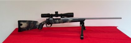

My latest 280 AI custom build, 7lbs 12oz scoped
