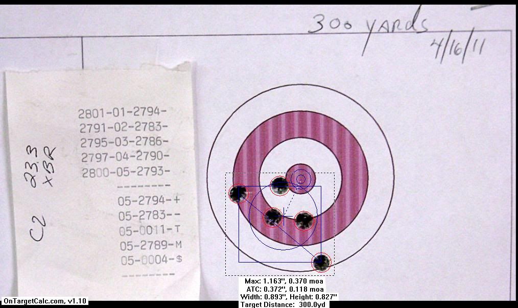

That's the best .223 (AR) group to date at 300 yards. Shot in a Colt 6724, Jewell trigger and Tubb flat spring and CWS, Leupold Mark4 - 16X with a dot. 24" - 5.56 chambered SS barrel.
Experience has shown that the powder is not as consistent as I would like from lot to lot. Velocity versus pressure is excellent however with heavier bullets in the .223/5.56 cartridge. I shot it today in a 6 PPC and was not happy with the results as to accuracy.
