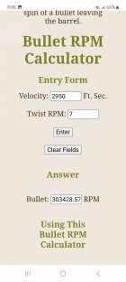

I may have missed it but there has been no mention of barrel length. I tried using that bullet for 1000 yard Palma and F TR shooting using a 30" 7Twist barrel. When I loaded them hot enough to stay supersonic at 1000 yards, I had problems with bullets blowing up and unexplained fliers. Conventional "wisdom" around the range held that the problem was high velocity and barrel duration with the 7" twist.
Something to think about. No problems in my 26-28 inch barrels.

You should not be going much faster than 2850 with a 7 twist. Above thaf it will shoot poorly with a 7 twist.
2750 would be closer to ideal.
