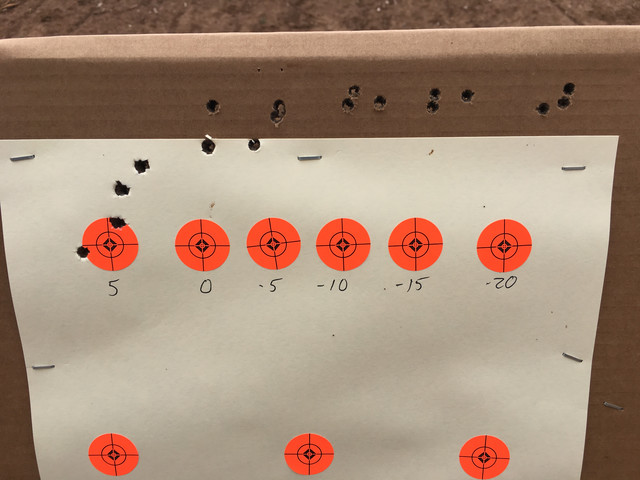

I have shot a few thousand of them and done load development on a couple of rifles for other people as well. I could only ever get them to shoot from .003-.005 off the lands. I don’t know what order these photos will upload in but there’s some 22 Dasher rounds; a seating depth test where jammed was filthy, -5 shot a little cluster and -10 and deeper were poor; and a very lovely 5 shot group from a sporter 22 dasher Beanland built as a coyote rifle. .005 off will probably work well for you, and if it doesn’t I’d just move on. No sense chasing it forever.

Thank you. My groups look just like yours. When I ordered these bullets everyone was saying how forgiving they were and how well they shot. And I haven’t seen that so far. Maybe it’s my barrel, maybe it’s me, maybe it’s the component combination. I don’t know, but I haven’t struggled this hard before with a custom barrel and a Berger bullet. I’ll try .003-.009 off the lands next and see how that looks. Thank you

As you can see, nothing forgiving about them all all. A dasher, a 22x47 and 2 22 creeds and if I wasn’t 5 off they shot like a savage. But.... 5 off always makes little dots. Strange strange bullet, but a coyote and deer hammer.
