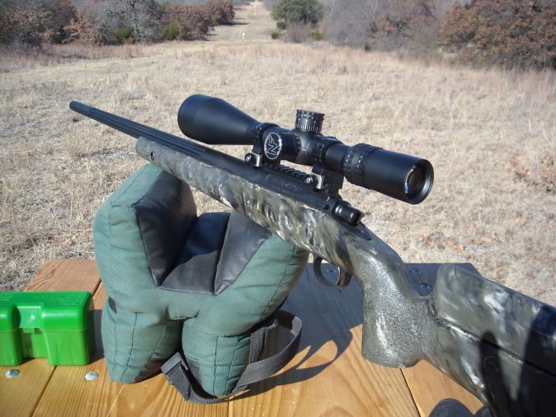

7mm WSM Tatical rifle
Nesika Action Trueflight 1:9 29" Dan Hardy Supressor
Winchester Brass
Federal Magnum Primer
Reloader 25 72 grains
Berger 180 Hunting seated 20 thou off the lands AOL 3.1"

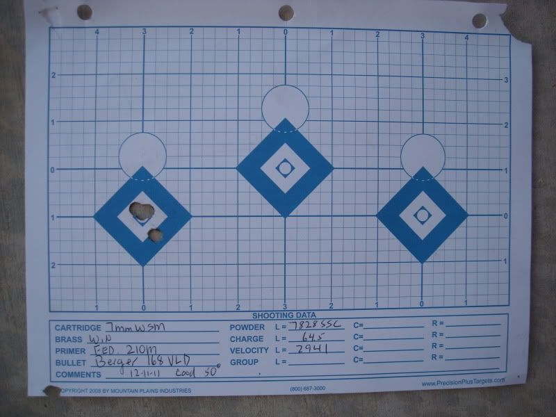

May have found my pet load;
7mmWSM
65.4 gr IMR 7828ssc
168gr Berger VLD Hunting
2941 FPS
Longshot Rifles
A-5 McMillan
Broughton 9 twist
Rifle Basix Trigger
Previous load 62.5 H4831sc

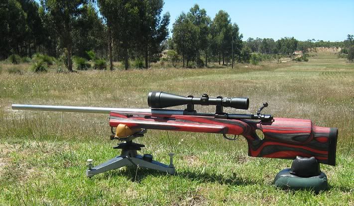

Just finished my 7mmWSM.
Zastava M70 Magnum Action
MAB (Australian) 1:9 31" Stainless Barrel Palma Heavy Profile
Simmons 6.5-20x50 scope in Warne Magnum Steel rings on Warne steel bases
Richards benchrest thumbhole cheekpiece laminated stock in "Black Widow"
Action bedded and barrel floating.
Winchester cases neck turned to .014" and annealed, Federal Magnum primers.
64gr Reloder 22 - 4 shots into .604 @ 100yds with 3 into .255" - this is my competition load from 600yds to 1,000yds (.25WSSM from 300 to 500yds)
Overall cartidge length 2.941" which is 10 thou from lands. Speed approximately 3,100fps.
Hornady 162gr A-Max BC .625.
