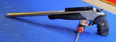

I recently fell onto a little different animal, a 15" stainless 7mm Raptor barrel by Gary Reeder complete with Hornady dies. Reeder uses the 204 Ruger brass to form cases necked to .284 for an increase in propellant capacity over the 7TCU (having the 222 Rem Mag as it's parent case). I can make no claims to it's performance yet, but I have great expecations having sufficient field experience with it's brethren, the 30 Raptor. It's kinda an exaggerated 30 Apache that shoots like a 30-30 but feels like a 30 carbine

Very nice!
I had an XP-100 chambered in 7X47, which is essentially the same thing as the 7 Raptor (i.e. 222 Rem Mag necked up to 7mm and blown out). I shot quite a few IHMSA matches with it. I ended up selling it to a guy in MI when I got out of IHMSA and downsized to just the hunting handguns.
