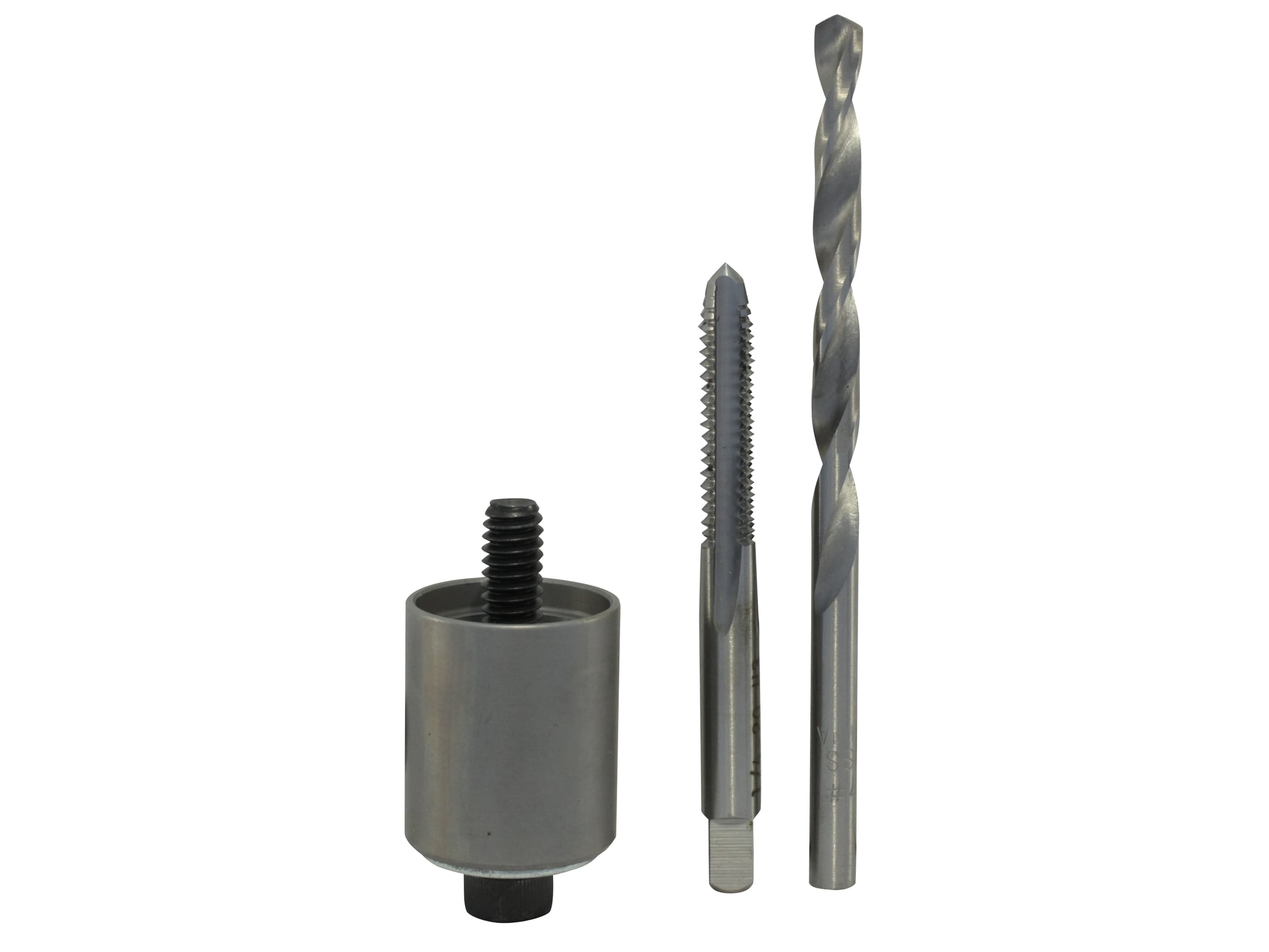

If you're reloading any wildcat cartridges you should have a stuck case removal tool
You can asssemble the necessary components easily.
1/4" drill bit, a socket, a hex wrench, and a 1/4-20 tap, and a 1/4-20 hex bolt
