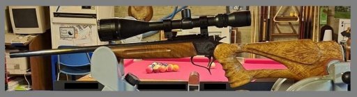

Coincidentally, I'm presently embroiled in a project that utilizes the 7-08 Ackley design on a 307 Win case resulting in a semi-rimmed 7-08AI in the contender! It's called the 7mm JDJ#2 or 7mm Super Bower or 7x307AI
a little fancy woodwork of mine on the back end.... W0W!
SSK Industries offers reliable and safe load recommendations for their barrels.
They made this one from a TC 7-30 Waters.

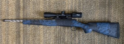

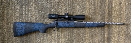

I built myself one on a Remington 700 action. It has an 18" barrel and with the carbon fiber stock, it weighs just over 7 lbs scoped. It is the perfect short-medium range whitetail rifle. Load is H4198 and 120 grain Nosler BTs.
