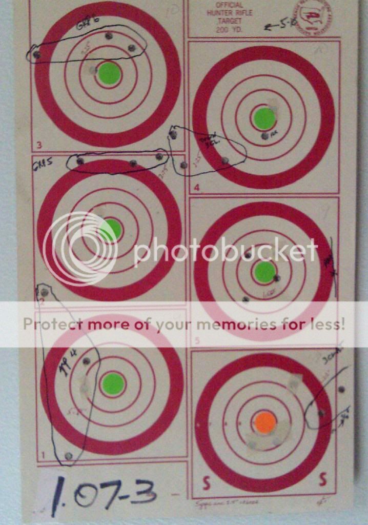

Shot my 7-08 Shilen DGA this am at 400 yds. Five groups (3 shots) averaged about 2.4". With 162 AMax, 41 to 43 gr W760, 3.080"OAL. Wind was about 10mph R to L. Velocity was about 2450fps. Loaded single shot. This is a fairly light barrel, MS wood stocked rifle, and a Simmons Whitetail Hunter scope at 20X. Bullet is about one half way into shoulder.
Not that great, but I like what I am seeing. The best group (42.0gr) appears to be the second bull from bottom, on left side. About 2.75" with no elevation. The next bull up, 42.6gr wasn't bad. Now if I can just remember my comeups for the next 200-400-100 yd match. Ron.
