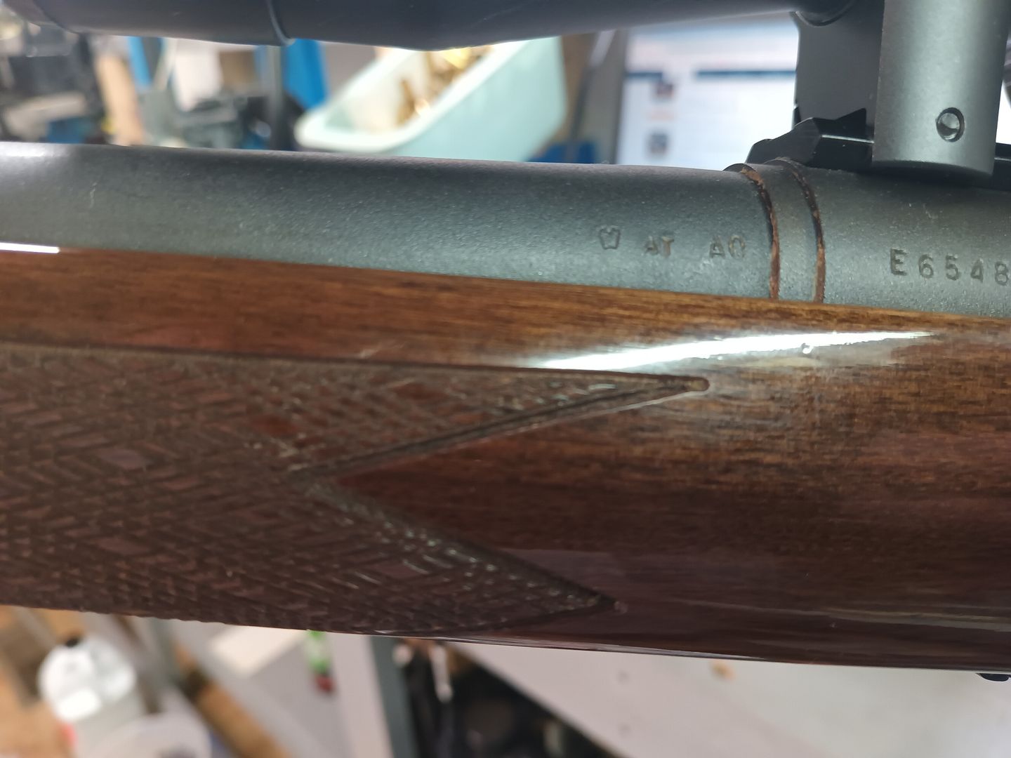

According to my SN the rifle was made after 1968 & not later than 1975. It is a BDL sporter in .223. Did this rifle come from the factory with a 1-12 twist?? I looked on the site but never found an answer. Thanks guys.....Lynn
There should be a two letter code on the left side of the barrel shank. The first letter will be one of the following:
BLACKPOWDERX
Where B = January, L = February, etc.
The second letter is the year, and can take a little deductive reasoning to get a good answer.
Are one of those sets of letters not circled?
No.
I'm going to guess it's the AT code, so March 1970. The other options for T are 1926 or 1999. The AO looks like larger font than I'm used to seeing for date codes, but maybe someone else can confirm that or not.
I also believe the rifle is later than 75 because of the finish. I measured the twist this evening & count 1 in 12. Is this correct for this model year rifle?
