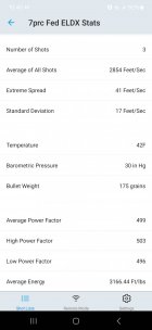

I have over 200 rounds of the Precision Hunter 175 gr ELD-X. And since I am a hunter, I am interested in 3 shot groups and it shot .64 inches. This is fine out to 600 yards though I am more likely going to be shooting at no more than 300 to 400 yards, plenty of impact velocity to petal out. In fact, I have recently entertained the idea of switching to CX Outfitter 160 gr for the mule deer in my state though I mostly hunt for whitetail. For that, any one of my .308s would do at 300 yards and closer.
Even if the factory is slower that the box, that is okay for me, as long as I know what the real MV is. And all the ammo out there is going to have different MV than the box.
