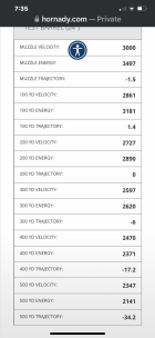

I’m assuming you shot two boxes of factory rounds. Hornady tests with a 24” barrel but their website shows 3,000 MV.

Thanks for the info. The factory ELDX is .062 jump. I’ll tweak that with hand loads. Even if you went with 175’s I’m not sure you’d get 3000 fps out a 24” barrel. Makes me wonder where Hornady gets these numbers. Not that I need 3000 fps. I’ll take less speed and tighter groups to a point.
