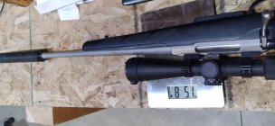

I had McGowen barrel make me a factory tikka contoured 18" 8 twist prefit with the muzzle flared up to .730 for 5/8×24 threads
The barrel came in at 2 lbs which is even lighter than I'd expected!
All set up with a vx5 HD in talley rings with the factory stock, and 9" Banish 30 suppressor it weighs 8lbs 5 oz.
I'm about a month out on a custom CF lightweight LR stock from MPI, it should come in sub 20 oz so the final weight will be around 7lbs 13 oz.

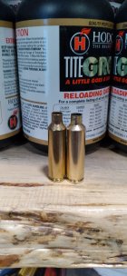

I'm still waiting for my custom dies from Hornady but in the meantime I used a 270 wsm die and a .284 expander to size a few winchester cases down.
I fire formed with 15 grains of unique topped with TP and got a near fully formed case, fully formed capacity is 82 grains with WW brass.
Pretty darn good considering the parent case measured 79 grains in 30 cal

1. Fireformed next to sized down parent case

3. Scoped and suppressed
