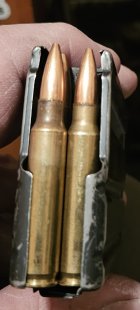

Workaround..
Steel 10 shot magazine windowed ti accept longer rounds.

In my 6x45 700Rem rifle, I'm using the ACCURATE MAG (SKU: 00100-0038) .223 5-round magazine, it can easily be modified to accept cartridge lengths close to 2.5". My 6x45 with a 80-grain Ballistic Tip bullet is 2.424" long and this magazine worked perfectly with a 5-min. modification. It feeds super smooth.
