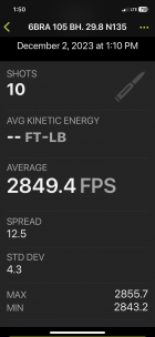

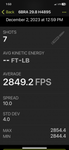

Just started playing with this. N135 was dead nuts on same velocity as the same weight of H4895 with a Berger 105 hybrid. I need to run a jump test to confirm accuracy but I would not kick it out of bed for eating crackers using the 0.010” off I am tuned with the H4895.
View attachment 1517590View attachment 1517591
What brass are you running? These look like some good numbers!
