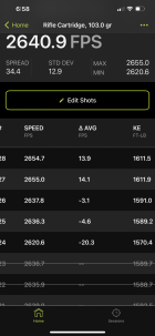

Here’s the chrono data on the last 5 shots.
